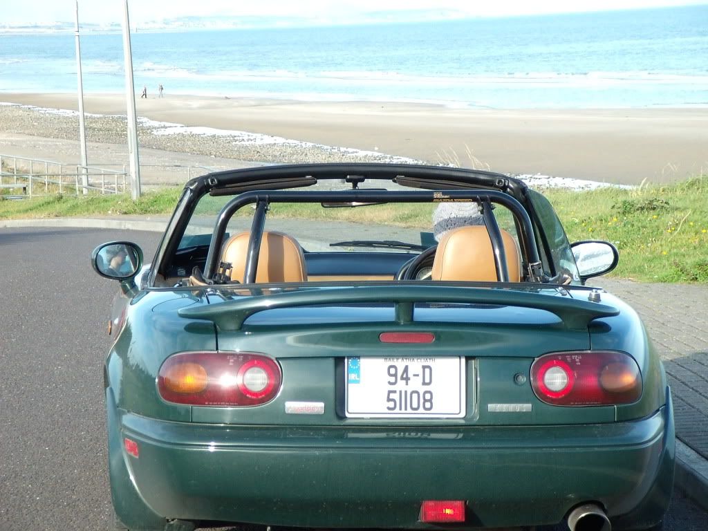

sidewaysreilly wrote:you saw it Ger, its a brickshithouse yoke. Not as good as a full cage but 10 times better than a style yoke or nothing.
+1
and whatever you have, you're in trouble if you roll her anyways :shock: :lol:
Re: Duck tail spoiler, hardtop and mazda speed half cage mk1
Postby sidewaysreilly » Tue, 01 Dec 2009 4:58 +0000
this be the one.........

Postby ger » Sat, 05 Dec 2009 12:23 +0000
sideways reilly said
Try to get a Mazdaspeed Rollbar if you can. They are very good quality and fitting is easy as they utilise origional fixture holes. I got one on e bay and over here for 135 euro. Stiffened up the car too with no rattles either.
ger said
Don't think it would withstand a roll tbh, try a harddog.
stig wrote, Yes it will as its designed to do so
are you sure about that?
I had a look at the mazdaspeed bar at the last run, it bolts to the seat belt towers, the bars facing the boot sit on the parcel shelf as far as i remember.
The harddog bolts to the chassis in 8 locations with 20 bolts and 4 under chassis steel plates.
Not very easy to fit and only uses existing holes for mounting at 4 points.
As you can see the side impact is greatly increased with a full size plated bar going from left to right.
I'm not trying to dis the mazda bar but I think its more of a style bar. If its not plated to the chassis then its not a roll bar. Style bars have been known to fold forward in a roll, imagine that if you will.

Postby Stig » Sun, 06 Dec 2009 5:14 +0000
srigley wrote:The sills look like they'll need doing.. also noticed a rust looking colour round the bolt holes in the front cross member under the bonnet. I'd check it carefully for rust elsewhere.
Barney, didn't get 5 mins to download/resize/put those pics up yesterday, sorry about that.
Heres a how-to from Microsoft : http://www.microsoft.com/windowsxp/using/digitalphotography/learnmore/tips/eschelman2.mspx
shes for parts that one. :?
Postby Stig » Sun, 06 Dec 2009 5:24 +0000
Ger,
I dunno what MS rollbar you were looking at, but it was'nt mine. Mine does not bolt to the parcel shelf, it goes thru that and is bolted to the chassis not unlike the HD one there you posted.
Any style bar will fold, totally agree - i'd rather not have one at all tbh.
