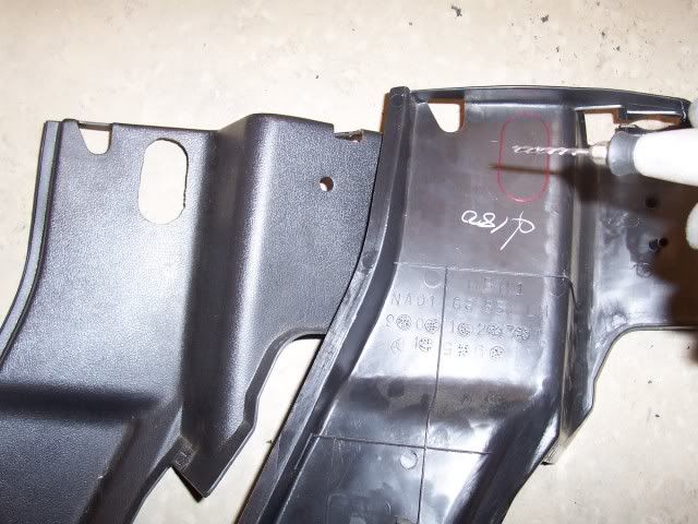

Luckily I came across a hardtop 20 miles away at the weekend, struck a deal and brought it home attached to the 2 front soft top latches.
Yer man gave me the internal sides latches also but have questions on how to attach same as it doesnt' have any markings so do I have to cut through panel? It's a 99 M2.
Also need to get 2 frankenstein bolts and get a re-spray as it's quiet marked along the ages and BRG as opposed to my black 2.
Any advice on fitting, bolts very much appreciated.
Thanks Ann :D

Yes, just remove the panel, not difficult, just a couple of screw/small bolts/curses and behind you'll see where the bolts like up. Cut an oval hole that lines up with the bolt holes and large enough so that the latch "sits" into it. I think its actually marked out on the rear of the panel..
Reassemble. Done. ;-)
Shouldn't take more than an hour if you have a dremel tool/small hacksaw.
