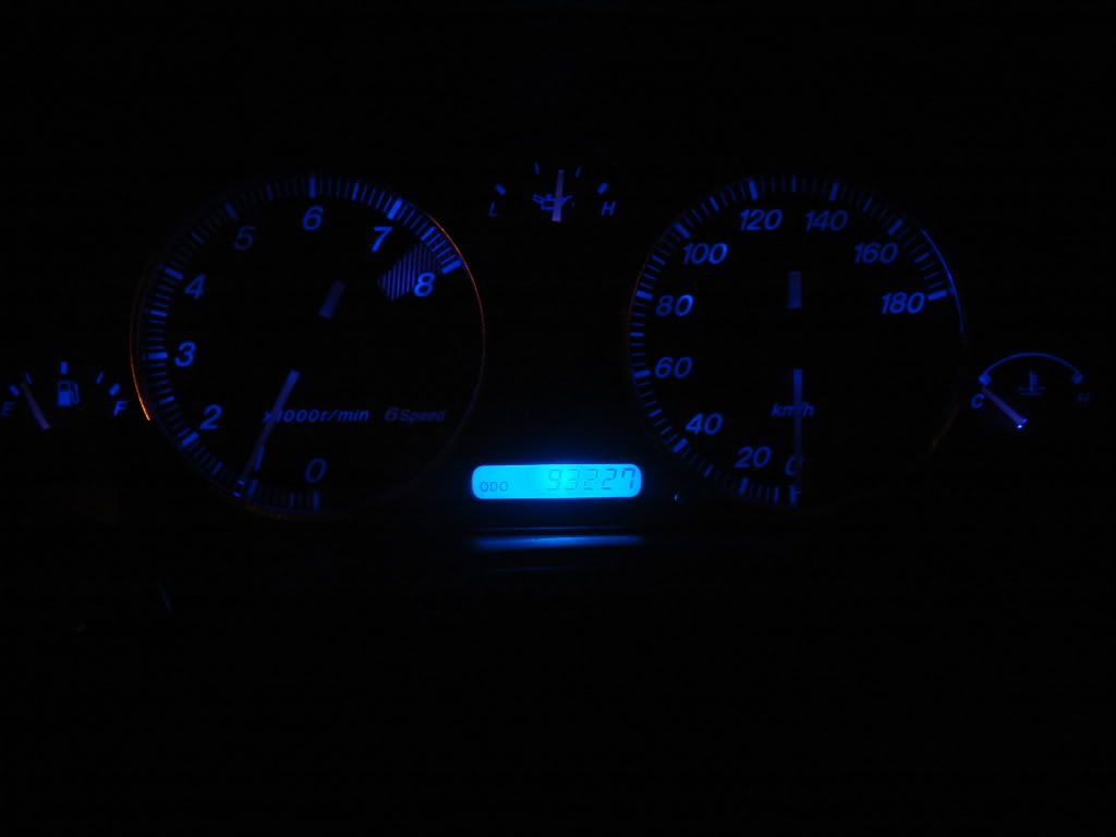

Changed my green instrument bulbs today to blue LED's - 20 minute job - took me a few minutes to figure out how to remove the binnacle - and the new bulbs will go in a couple of ways, but only one way will work - so a bit of trial and error there - nery happy with the blue - matches the blue interior of the rest of the car...
First - remove 3 philips screws underneath the instrument binnacle...

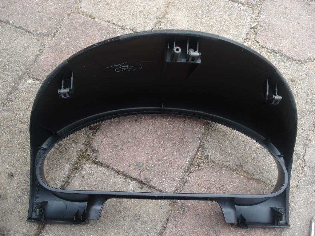

Then seperate the top from the bottom part - just clipped together - gentle squeezing will remove top part

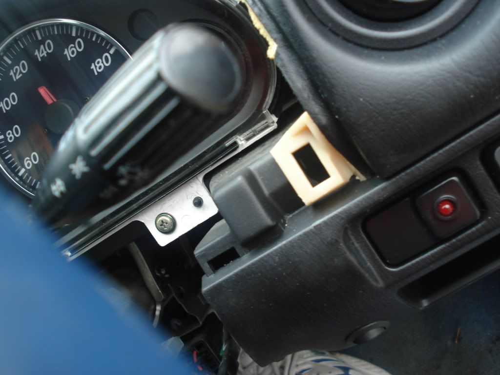

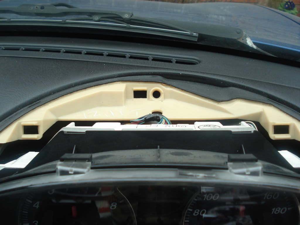

Having removed the top part, no need to remove bottom part, you then can remove the binnacle. This is held in by 5 clips - 3 on the top and one each side on the bottom. I found the easist way was to put my thumb behind the bottom left side and gently prise away, then do the same on the right hand side, then gently grab the top of the binnacle and pull it towards you - comes off easily

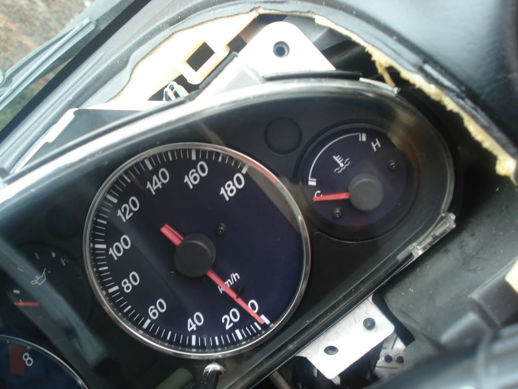

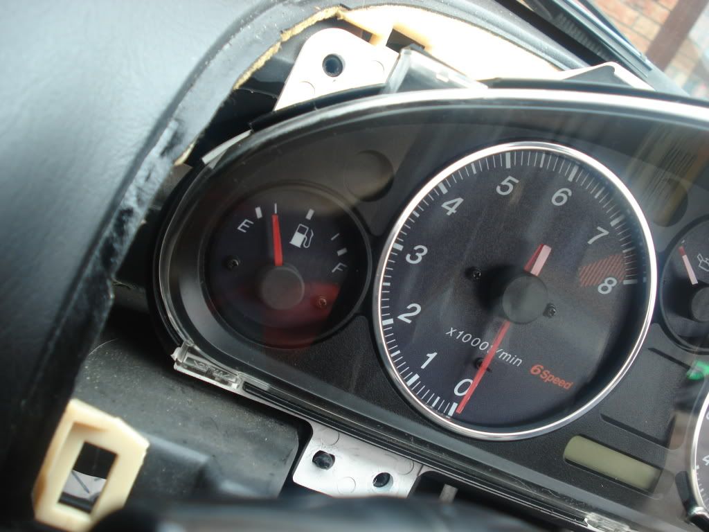

You should now clearly see four philips screws that hold the instrument panel onto the dash - remove all 4 screws

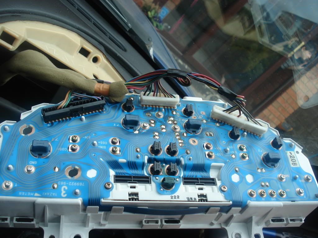

- lift out the panel and turn it around - hey presto - you can now see the four blue horizontal bulb holders and the one green vertical bulb holder
- just twist each one individually an the holder comes out with the bulb - to remove the bulb just pull it gently - insert new bulb - turn on lights to ensure that it works -if it does'nt remove the bulb and turn it around - they only work one way
THe finished reslut after putting it all back together....

Postby sidewaysreilly » Sat, 13 Mar 2010 10:41 +0000
Nice job.

Postby leamyj » Sat, 13 Mar 2010 10:56 +0000
Good one Rob. I see that the 10AE speedometer is not driven mechanically as is the mk1, that can often be awkward when removing the cluster on the mk1, seems that yours would be easier. Were you replacing with a bulb or some type of LED, dont know why a bulb would have to be reversed as they usually work either way..DOH!!! Just re-read the first line of your post :oops: :oops:

Postby franksm » Sat, 13 Mar 2010 11:05 +0000
Nice write-up ! Love the colour scheme.
I guess the various switches would need to be taken apart and have an LED soldered in

Postby Steve » Sat, 13 Mar 2010 11:29 +0000
Class! Looks great!

Postby CashelMX5 » Sun, 14 Mar 2010 2:12 +0000
Nice one Rob, looks the business. Did you manage to get the footwell lit as well?
