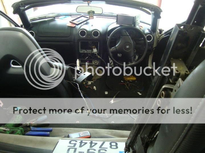

Just got these fitted to my rs, very tight fit but came out pretty well I think, their wired in and all

was there much work involved in making the rails fit ? Any details ?

charged_rs wrote:nice
There was abit of work in fitting them alright, I think the rx8 seat brackets had to be cut with new pieces welded onto them, you couldn't just unbolt the rx8 brackets cause we wanted to keep the electrics, their a little high but not that bad, I'm about average height and I still have good clearance towards the roof

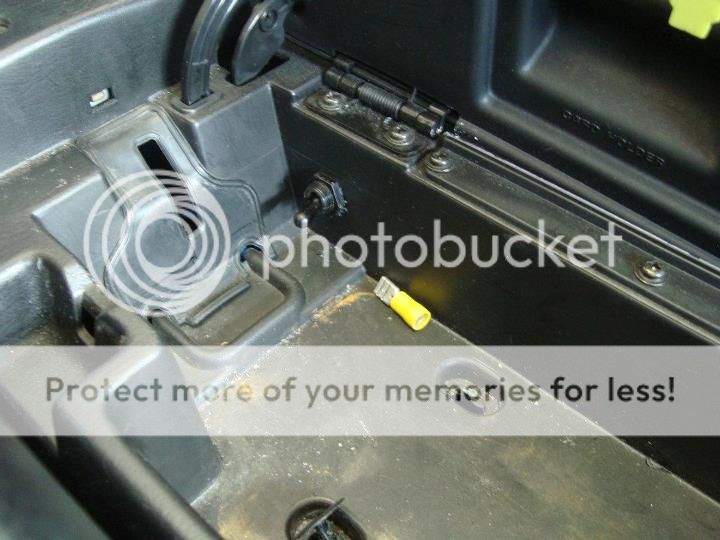

Here's where the switch is for the heated seats, it's fused and all so will pass nct no problem
