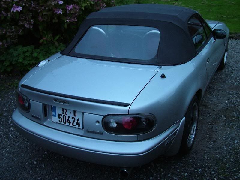

Boot lip spoiler fitted

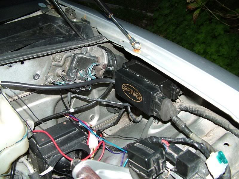

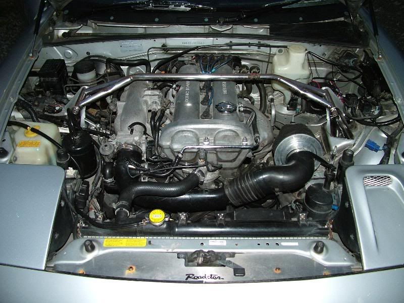

And the link ecu is installed and car is running. Not done much tuning on it yet and Dave is going to make me a nice cross over pipe.
Been out for a quick play this evening and I will say so far the car is running pretty sweet. Seems to pull better, throttle response is faster and it seems over all to be faster. Also sounds pretty sweet. :lol:
Install so far
Man i have a lot to learn!!!!!!

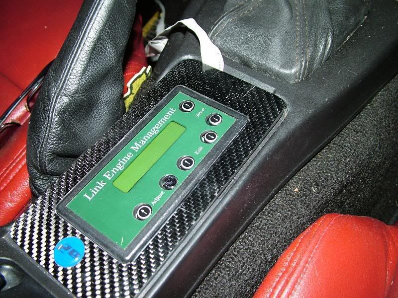

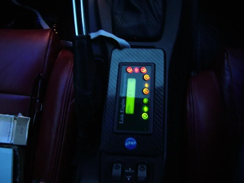

I assume you'll be able to hide the ribbon coming from the controller?
The lip spoiler..How is it attached?

Yeah the ribbon will be hiden under the centre consol eventually.
Spoiler is stuck on with 3m double sided tape. seems to be pretty firm. Time will tell if it flys off at high speeds but i doubt it.

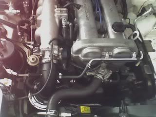

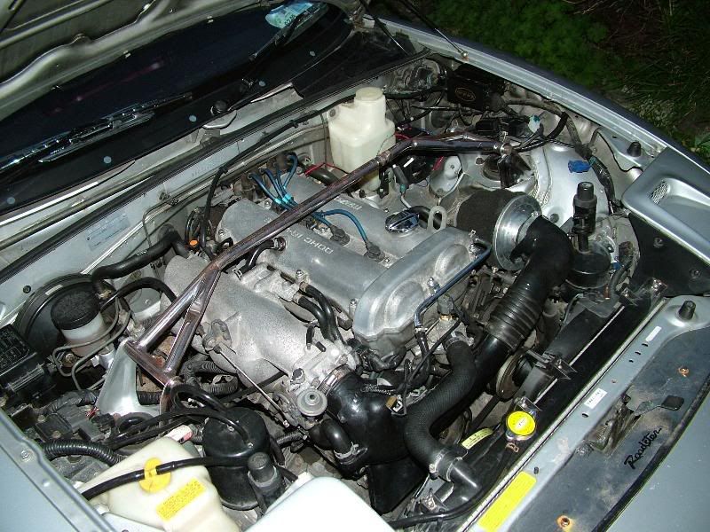

Lookin good Ash! Where you thinkin of locating the air filter eventually? Must look for a pic of the setup I had pre-turbo, t'would be great to put a scoop just straight out from the intake manifold to get the "over the radiator" air..

Not sure re intake, pics of yours would be great. Gonna meet up with Dave and see what he could make up for me.

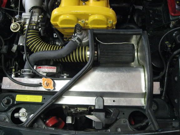

This looks interesting for the intake.

Postby Steve » Sat, 20 Sep 2008 4:50 +0000
mx5ash wrote:Oh i wonder how Daves fabricators are!!!
:lol:
Thats the image I was looking for! Interesting to see the little filter put on the pipe that comes from the left of the intake manifold , didn't know you could do that..
Postby mx5ash » Sat, 20 Sep 2008 8:48 +0000
Nor did i till you pointed it out.
Was down at daves this evening looking at what could be made up in the way of intake.
That little filter could solve a problem.
Think we are looking at something like the first picture i posted.
