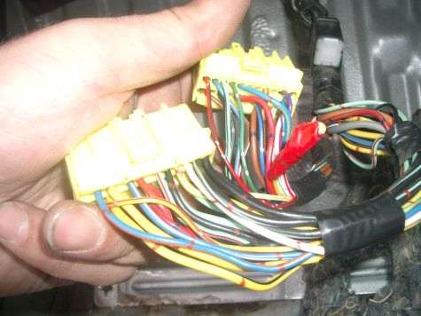

I even got intimate with the wiring... I know! Me... and a wiring diagram! *splutter* There was that first "Now, identify the correct wire, and cut. Tape this back as you will no longer need it" moment... which resulted in lots of "are you sure?" queries from me.... but expert aid was at hand... and alternatively, a complete other Roadster sitting next to mine from which to cull bits should the need arise. Obviously while Steve was making a cuppa coffee or something! * hehehe *
Which one sets the timer counting down again? Watcha mean... don't cut the blue one, I thought you said DO cut the blue one. Bugger! ![]()
