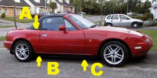

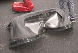

Firstly let me explain the route the water takes. Any water that runs off to the rear of the hood runs down over the back and into a rain rail (see photos 1 and 2 below) which directs the water to 2 holes located in front of the upper seatbelt mounting (photo 3, point A) and exits through a rubber pipe approximately ½” in diameter just forward of the rear wheel about 8 inches in.
PHOTO 1: An MX-5 rain rail. |
PHOTO 2: The rain rail attached to the hood. |
Any water that runs off the front of the hood gathers in that little rubber bubble you see at the top side of the A pillar (windscreen frame) and runs down the side of the door and exits through a slit in the sill at point C.
