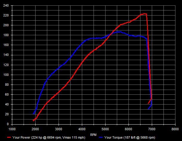

Postby sidewaysreilly » Thu, 14 Jul 2011 11:17 +0000
would be with a turbo Steve as its not reliant on revs.
Remember the old formula from James Watt and its still the same one used today.
Horsepower = (torque x revs) divided by 5250
5250 is the crossover point where torque and power curves intersect.

Postby Steve » Thu, 14 Jul 2011 4:24 +0000
sidewaysreilly wrote:would be with a turbo Steve as its not reliant on revs.
Ah ok, long stroker etc
Wet liners, why are they better?
5250, yep, heres a power run (from last year I think) which shows it :
rough figures : (178 x 6600) divided by 5250 = 223(ish)
