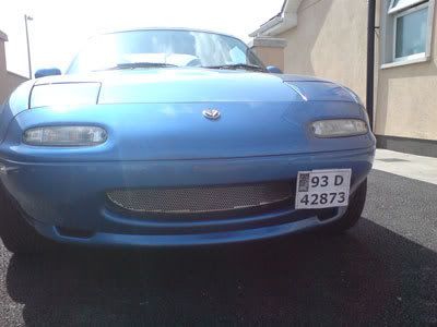

So i decided to make up a side mounting reg bracket, seen as I backed into my own car and damaged the plinth :oops: :oops: :oops:

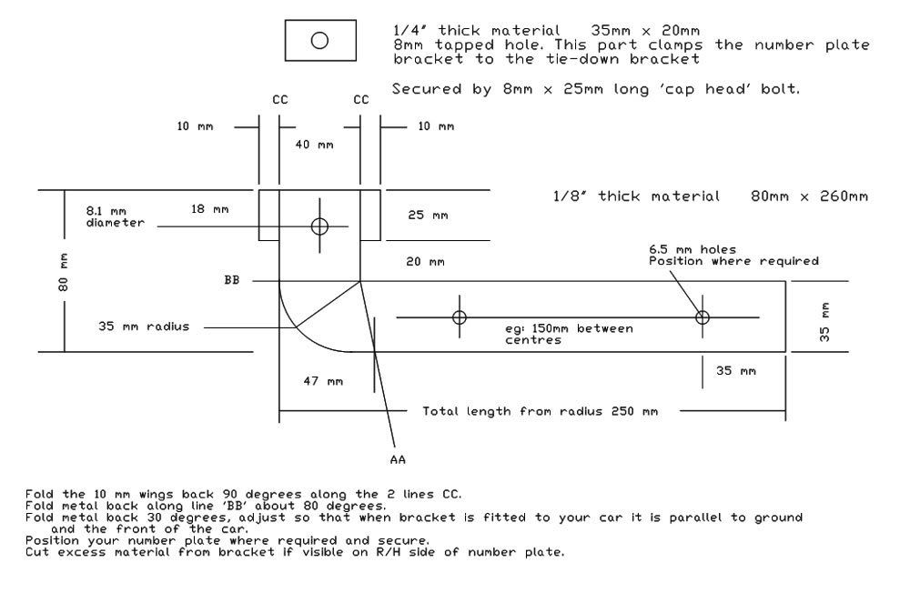

Heres the drawing I found on the english OC site!

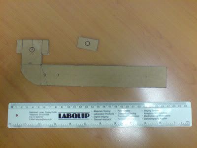

So I went and made me a cardboard cutout to see how she looked
This mount turn out to be very low. So i did a bit of a redesign!

This didn't work, so I have redrawn the bracket and I'm going to get it made as specified in the original UK OC drawing at 1/8 inch or 3mm.
see dummy reg print off stuck to the bracket below.....
Here's my final design if anyone wants a go for themselves.

I know I could have paid €40 euro off autolink for a cusco one, but then I wouldn't have had the enjoyment of making one to fit, and at least now I know exactly what I'll get...... 8) 8) 8)
