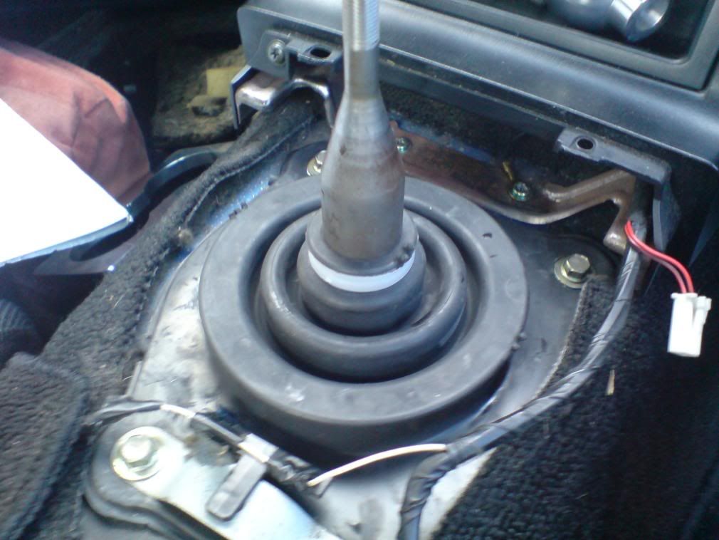

nah! if its anything like the standard one, just undo the bolts for the gaitor and it just drops in......
undo four bolts to remove this cover

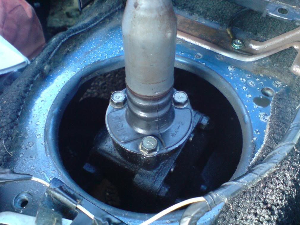

undo another three to remove this one
very handy.....ye might need to change boots anyway

Yeah, got it done - it was just a screw on one to the original gear stick.........nice real racey feel to the gear shift now, hand is now nice an close to the steering wheel for those quick shifts.
The Shift Extenter was $20 from Bill @ Miata Roadster. I got a 8 ball knob too of ebay so all in all, its fun! :lol:
