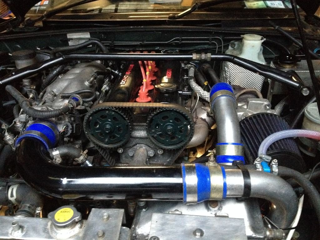

Postby sidewaysreilly » Mon, 16 Mar 2015 9:46 +0000
Tidy and tuning to go.

Postby sidewaysreilly » Wed, 25 Mar 2015 11:49 +0000
MK2 RS Engine,
6 speed with 3.9 Torsen Diff but will be changing to 3.6 soon.
TD04HL16T Turbo on custom manifold and downpipe.
Oversized Chargecooler with Johnson Pump.
Coolant re-route with Civic type Rad.
Link ECU with patch lead to join into jdm loom.
Not gonna go mad with boost as air temps are very low and turbo is same size at gt2560 (ish).
AEM Wideband.
Soon to be installed Mintex 1144 pads up front.
Pissed off waiting for NCT date as its insured and ready for tuning.
Oh and a BMW Vortex oil separator which will sit where old stat used to be.

Postby sidewaysreilly » Sat, 28 Mar 2015 8:51 +0000
No, I bought it off Frank . Its OBD2 so 3 plugs . Had to make up a lead and gets sockets to join the original 2 plug loom into the 3 plug Link ECU.
A right bastard of a job but works good.

Postby sidewaysreilly » Sun, 12 Apr 2015 11:53 +0000
NCT passed but emissions were on the limit. Tuning now but fuck its quick !
