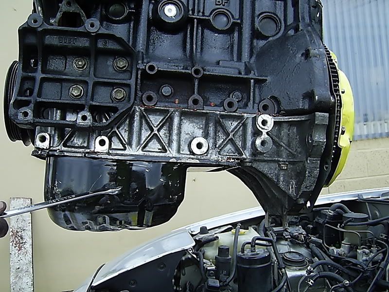

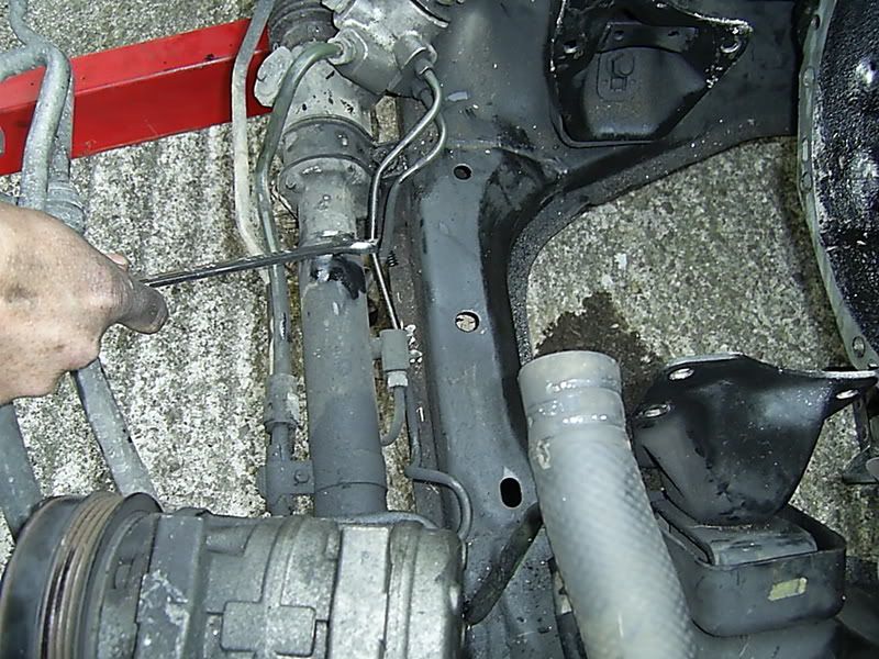

Right guys major problem, the new engine wont fit!!!!
The new engine sump
is hitting this
And is totally different to the old engine's sump
What the hell is going on???

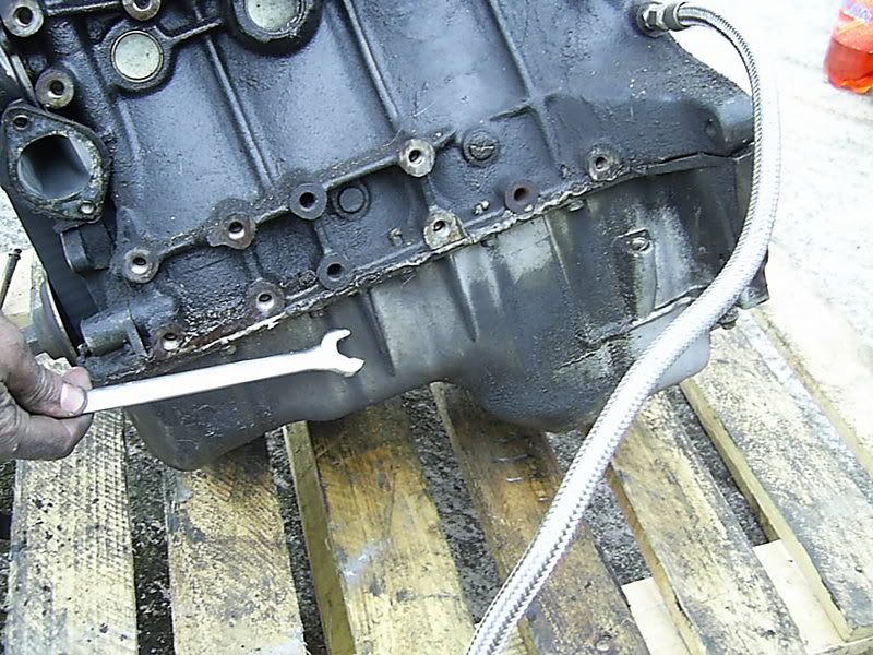

looks totally different, old oil sump is 1 piece the new one is 2 piece (the black part is separate)
both have b6 stamped on them, both 1.6 mark 1 engines.
Gutted for Sean is not the word.
Postby mx5ash » Sun, 15 Jun 2008 9:37 +0000
to answer my own question, they changed the bloody sump post 1993, according to this
http://cgi.ebay.co.uk/ws/eBayISAPI.dll?Vie...1&indexURL=
So next question, are they interchangeable??? Ie can we swap the sumps over?

mx5ash wrote:to answer my own question, they changed the bloody sump post 1993, according to this
only way to find out is to try swapping them.

Postby mx5ash » Mon, 16 Jun 2008 1:12 +0000
Wouldn't be enough room to tighten all the bolts on th pan john. Also if it is from a later car then there is going to be 25 missing pomies. Also some guys on the uk forums are very suspicous about what this came out off and what the hell it is. (apart from a car and an engine for any of you wise guys!!!)

Postby Steve » Mon, 16 Jun 2008 1:46 +0000
depends where the collector is on both of them..
I don't think thats an MX5 engine tho.. let me go ask someone about that..
Postby Steve » Mon, 16 Jun 2008 2:31 +0000
no, they don't think its an MX5 engine either..
There was only one subframe afair for the mk1, so that should confirm it...
I'd get back on to the dismantlers and tell him to come pick it up while he's dropping off the correct engine.
